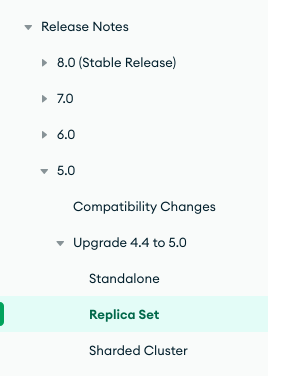

I am managing a three-node MongoDB replica set currently running version 4.0. I am planning to upgrade it to the latest stable version, 7.0, following the recommended step-by-step upgrade path:
4.0 → 4.2 → 4.4 → 5.0 → 6.0 → 7.0
Here are some details about my setup:
- Storage Engine: WiredTiger
- Operating System: Ubuntu 18.04.2
- Upgrade Method: Replacing MongoDB binary files (
mongod,mongos, etc.) for each version.
Before I begin, I want to understand what potential issues or risks might arise during the upgrade process, including but not limited to:
- Data corruption or loss
- Compatibility problems with existing data or configurations
- Downtime or service interruptions
- Unexpected behavior during binary replacements
Additionally, I’d appreciate any best practices or precautions I should take to ensure a smooth upgrade.
