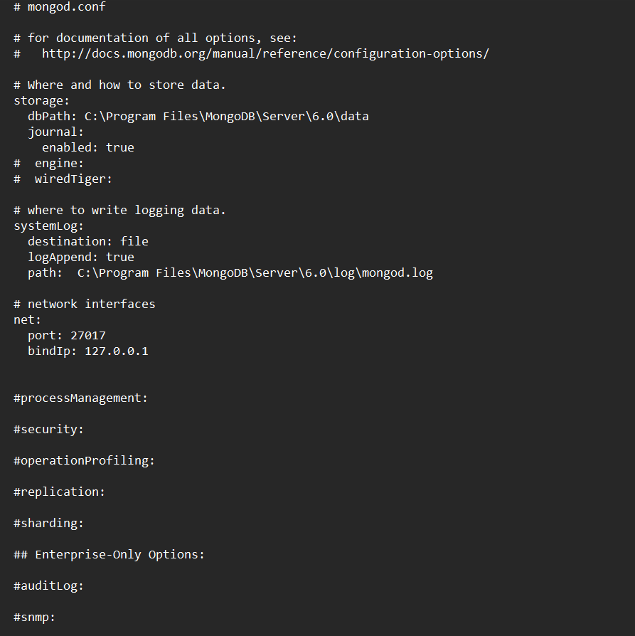

The config file is the one here “C:\Program Files\MongoDB\Server\6.0\bin” if so, what parameter do I edit and how?
Currently, it’s like this.

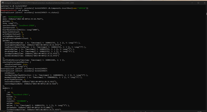

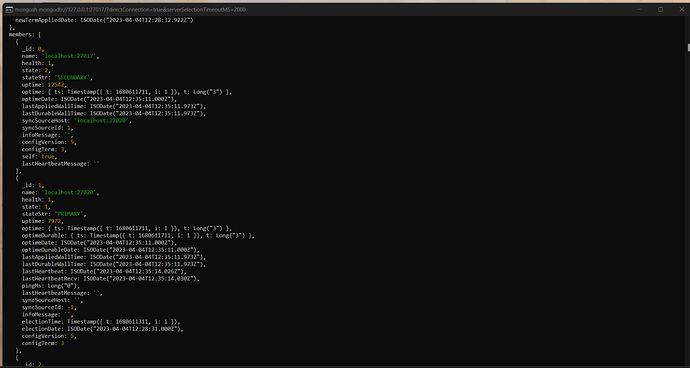

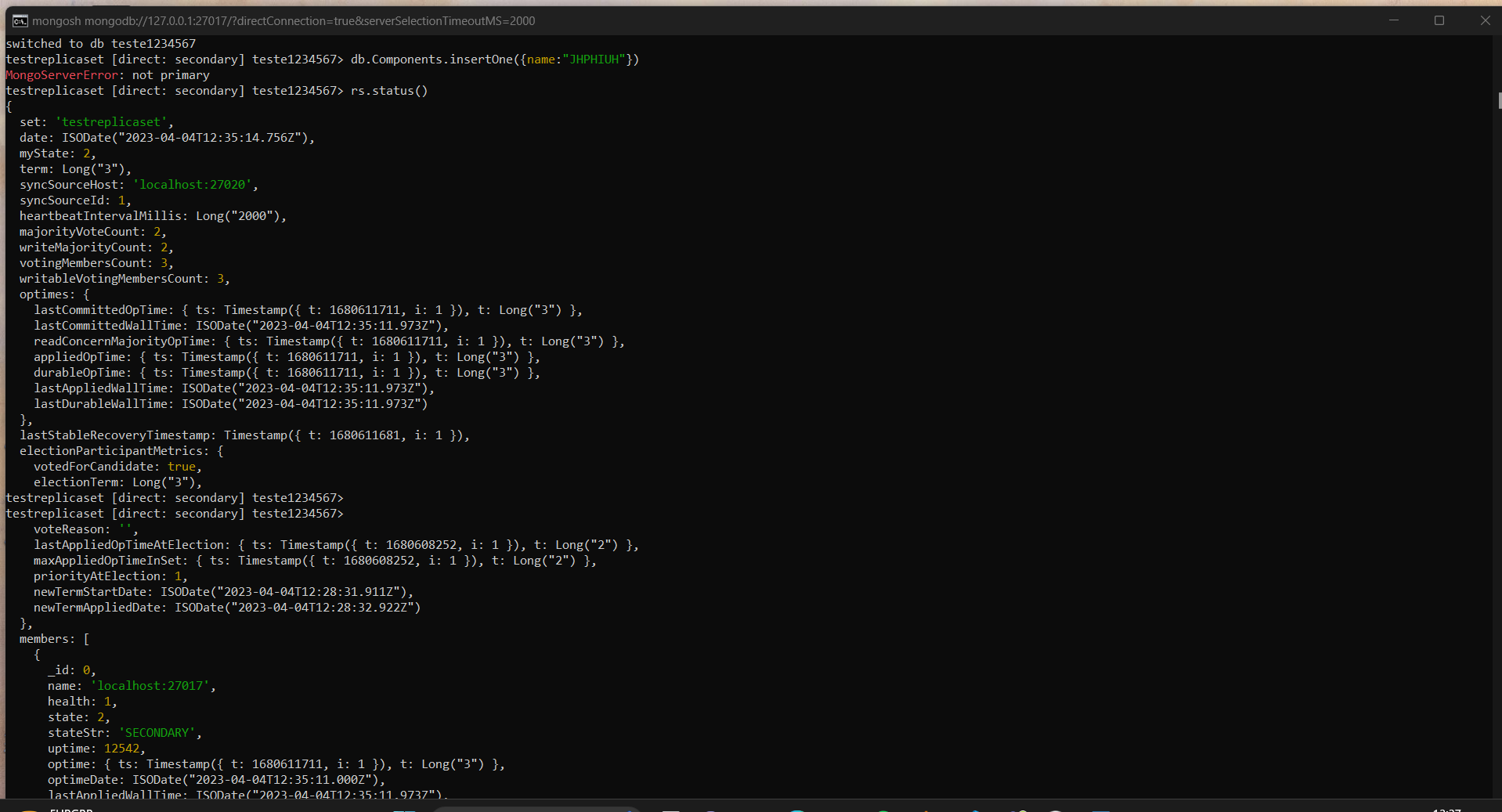

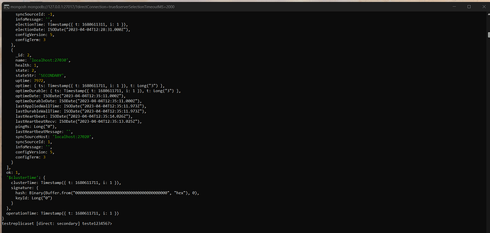

Port 27030 now is primary for some reason, what do I need to retrieve from rs.staus()?
So is your replica up?
rs.status shows status of your replica like which node is primary,node status etc
It is now I’m afraid if I restart my pc all the replicas will be gone. This is what shows after rs.status()

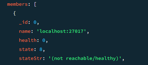

Now when I do rs.status() the port 27017 shows like this
Since it’s working, I guess there is nothing to worry.
Replica sets are now working, thank you, Ramachandra_Tummala for your patience and time.
