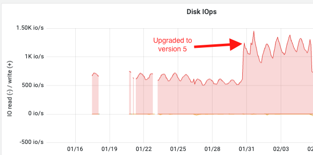

At first we didn’t notice any changes and degradations in terms of application operation. But monitoring started to show io utilization growth of more than 80% right after upgrade to version 5.
Screenshot 2024-02-12 at 11.23.15
Screenshot 2024-02-12 at 11.24.06
Screenshot 2024-02-12 at 11.25.03
On all machines the same picture.

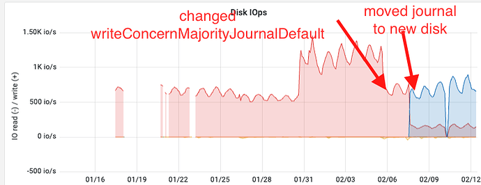

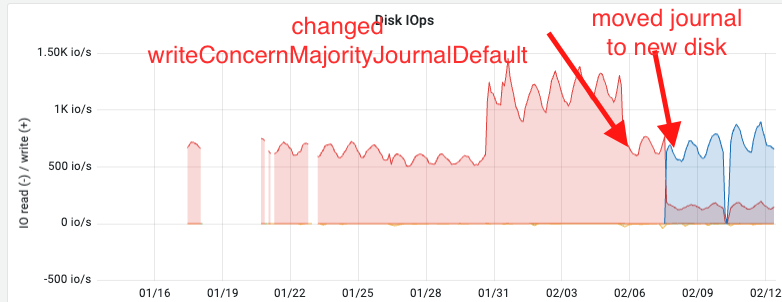

According to the documentation https://www.mongodb.com/docs/manual/reference/replica-configuration/#mongodb-rsconf-rsconf.writeConcernMajorityJournalDefault
If any voting member of a replica set uses the in-memory storage engine, you must set
to false

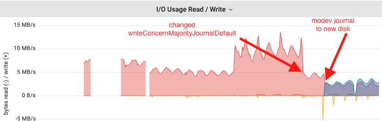

We changed it, IO reads and writes have dropped and utilization on the master has also dropped, but on replicas the figures are the same.

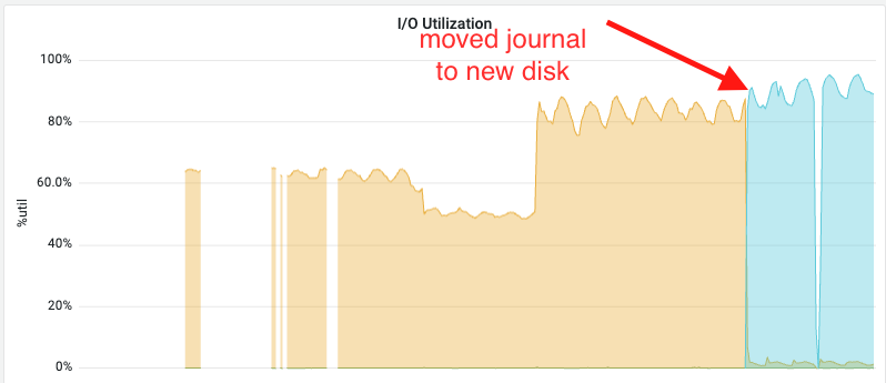

After that, we decided to try to move the journal to a separate disk, all utilization went to the disk with the journal.
After a while, we started catching various side effects.
I don’t really understand where to dig and how to remove utilization from journal disk. Any advice would be appreciated
