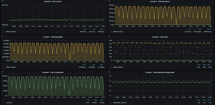

I have added extra volume exclusive to journal and we see, 100% disk usage with 500 IOPS. So probably that’s where our problem is.
Hi @Denis_Bartashevich
Glad you found the root cause. Yes that graph looks like the disk is struggling to keep up with the work assigned to it. If you can try to provision a faster disk, you might see some improvement.
