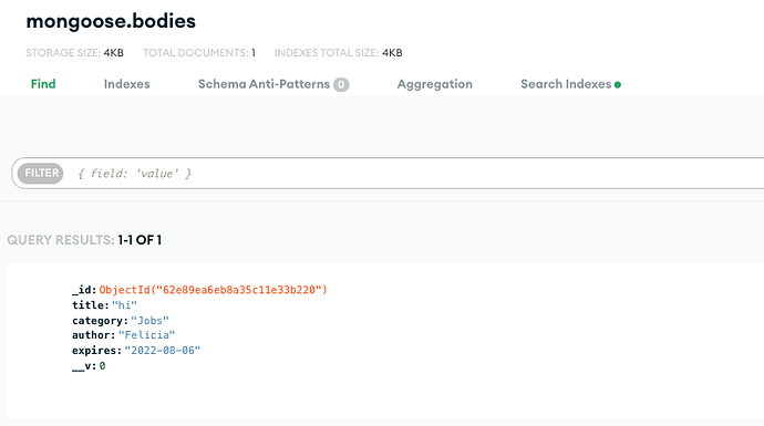

The resulting document that is inserted:
"_id":{"$oid":"62e89ea6eb8a35c11e33b220"},
"title":"hi",
"category":"Jobs",
"author":"Felicia",
"expires":"2022-08-06",
"__v":{"$numberInt":"0"}
(In Data Explorer):
