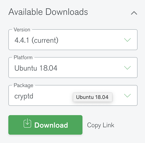

hi are you downloaded ‘mongocryptd.deb’ with these config?
I am not able to install mongocryptd.deb due to dependences.
