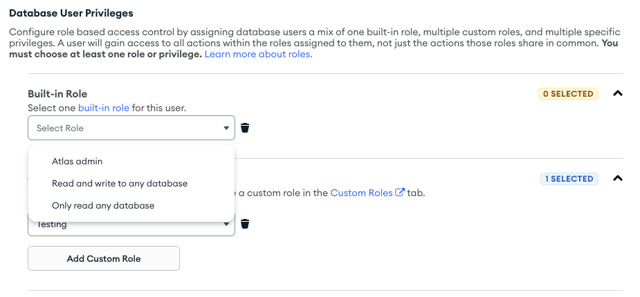

Hi, I’ve created a Custom Role to limit access to a specific database, but the new User modal is forcing me to also choose a Built-in Role, which would either grant too much or too few privileges, or does it do something else? The documentation is confusing.
So, I’ve gone and created a user for unit testing with the “Only read any database” as the Built-in Role, going with the least privilege principle, and in the Custom Role, I’ve tied it to a specific database.

Hi, sorry, I misinterpreted your question. You do not have to select a built-in role. You can just click the trash icon to hide that selector and then select a custom role. Alternatively, clicking outside of the modal will automatically unpopulated that selection it would appear.
I do agree it is a touch confusing so I will pass this feedback along to that team.
Let me know if this works for you?
Tyler
Hi @Tyler_Kaye, I sort of stumbled upon what you’re recommending.
Screen Shot 2023-03-28 at 14.26.16
