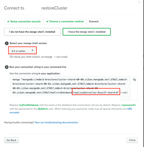

I can see you have used Sandbox as your replicaSet name when performing the mongodump via your second method. To get the correct replicaSet name for the Atlas cluster to be used in my above example, you can go through the connect modal in Atlas for your cluster and choose mongoshell, from there you can change the version to 3.4 and you will find the replicaSet value as shown in the example below:
