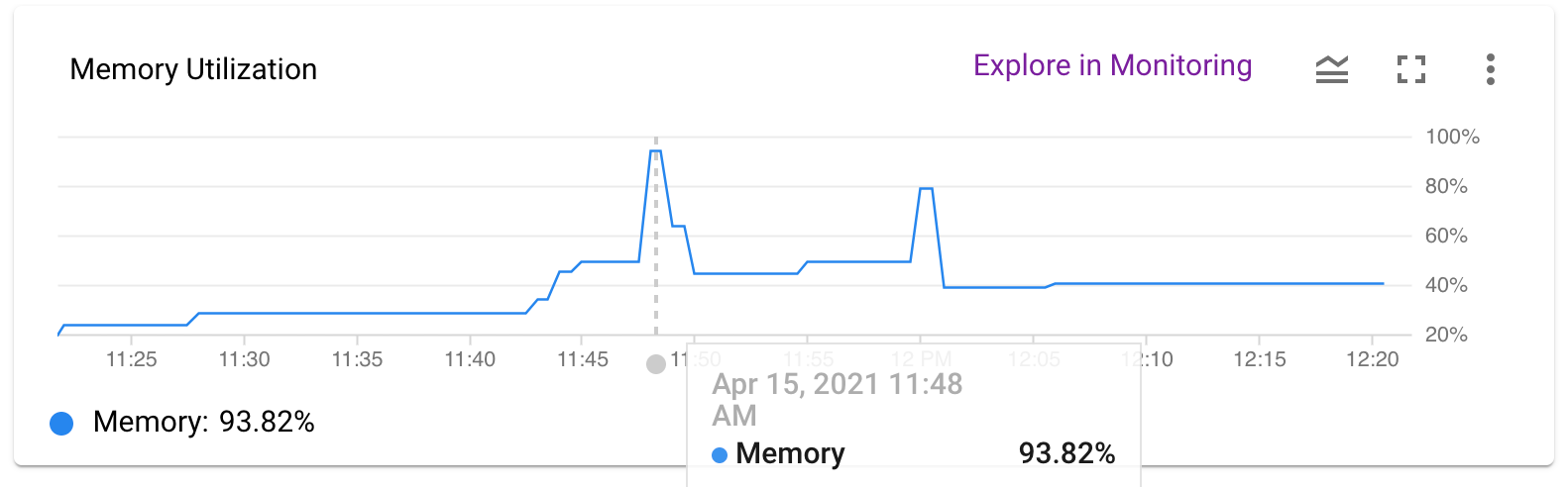

I managed that by temporarily resizing the Compute Engine VM. Memory usage while running mongorestore --nsInclude="simulations.history" [etc.]:
This is while restoring one collection with storageSize: 18753490944.
In comparison, mongodump (version go1.7.4) dumped and gzipped that 9GB archive on the same VM as the running mongo server 3.2.11, a VM with only 1.75GB RAM and no swap space.

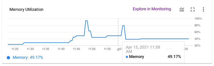

Maybe “steady state” use:
