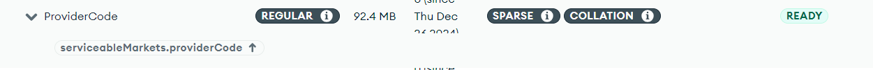

I have created an index on providerCode field

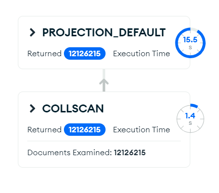

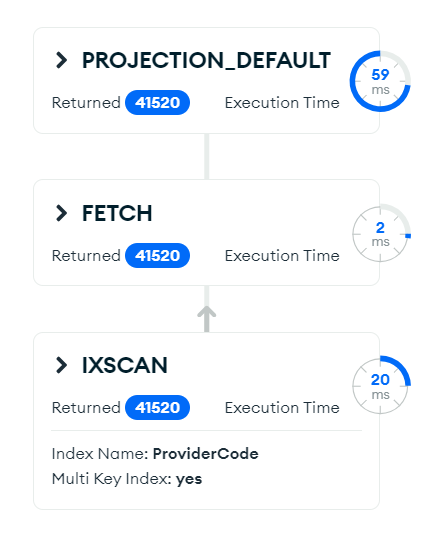

Due to the projection, my aggregation is skipping index whereas if I switch off the projection stage then my index is working. What changes do I need to do for the index to work?

“winningPlan”: {
“stage”: “PROJECTION_DEFAULT”,
“transformBy”: {
“_id”: “$_id”,
“addressLine”: “$addressLine”,
“serviceableMarkets”: {
“$map”: {
“input”: “$serviceableMarkets”,
“as”: “dtoServiceableMarket”,
“in”: {
“marketId”: “$$dtoServiceableMarket.marketId”,
“providerCode”: “$$dtoServiceableMarket.providerCode”
“apartments”: “$apartments”,
“zipCode”: “$zipCode”,
“city”: “$city”,
“state”: “$state”,
“stateCode”: “$stateCode”
“inputStage”: {
“stage”: “COLLSCAN”,
“direction”: “forward”
“rejectedPlans”:

As you suspected in
the $project is the culprit. The server cannot assume that the index on the original documents could be use after the $project since it changes the structure of the documents. In your index probably could be used but determining that could be expensive for the server.
If you move the $project after the $match the index will probably be used.
Anyway, if you think about it, index or not, doing a $project on all documents then filtering a subset with a $match is certainly less efficient that filtering first and then altering.

One more thing I have witnessed is that if I modify my $match stage by replacing $elemMatch with a filter directly on the field. The index is working along with $project
  "serviceableMarkets.providerCode": "GHI"
Following is the explain plan

I am very much confused at this stage about index behaviour working with field level filter and not working with $elemMatch.
I hope I am able to explain my scenario and situation. Any advise here would be helpful for the resolution.
I think that this is really the key of the issue. When you do
You are querying the array serviceableMarkets, while with
You are querying the indexed field serviceableMarkets.providerCode.
While the server could try to analyze the inside of $elemMatch to see if all the queried fields are indexed, I think that it might be too complex or expensive to do just to accommodate some edge cases like yours.
I think that once you know $elemMatch might force a fetch before deciding if documents match or not, you can decide not to use it when querying a single indexed array field.
