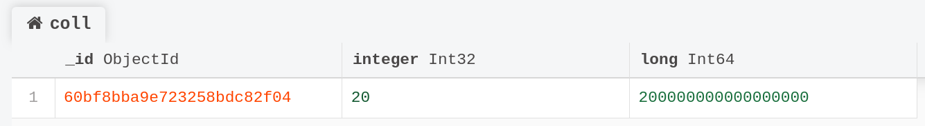

{"_id": {"$oid": "60bf8bba9e723258bdc82f04"}, "integer": 20, "long": 200000000000000000}
Sooo apparently 200000000000000000 IS a legit “number” value for a JSON file and it’s also the default behaviour for toJson().
Here is my doc in Compass where we can clearly see the types:
