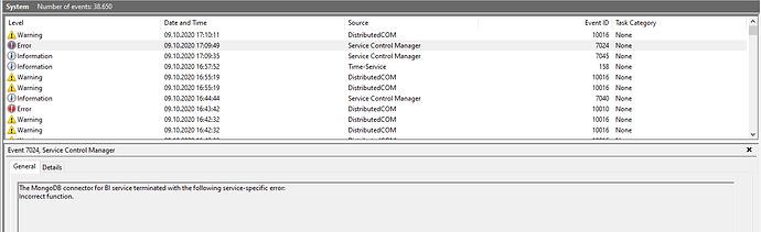

Looking at the event viewer it only tells me this:
