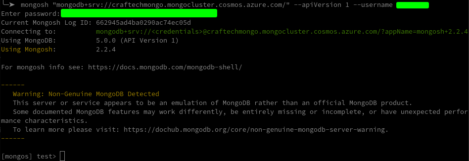

We’re not able to validate the source due to Atlas not being able to resolve its host:
However, when using Mongo Shell we’re able to connect without issues:

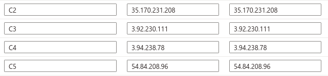

Needed IPs added to Firewall

I saw that your problem is more related to the connection, however, Live Migrator does not support migrations with CosmosDB as the source because this requires Oplog, which CosmosDB does not have.
The strategy is to import/export or use a tool like Apache Kafka to reduce the impact of downtime. See this link: Migrate from Azure CosmosDB to MongoDB Atlas Using Apache Kafka | MongoDB
