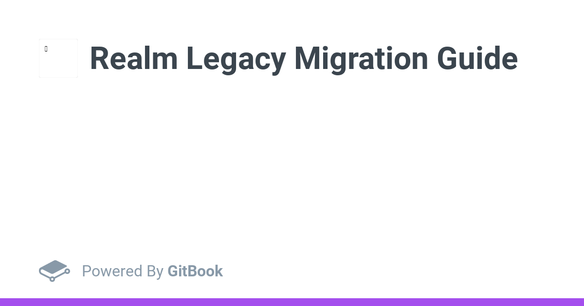

I know a bunch of you have been looking for a guide on how to migrate from the old versions of Realm Object Server and Realm Cloud to MongoDB Realm. We’ve put together a guide here -
We would be interested to hear any and all feedback and how we can improve this doc over time.
