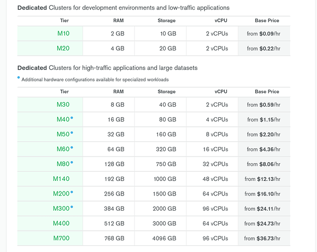

What I’m about to say is really not accurate and should not be taking for an absolute truth, but usually I would recommend to have about 10-20% of the node size in RAM.
So for example if you have a 200GB replica set (200GB per node). I would have around 20 to 40GB of RAM. Unless there is really something out of the ordinary going on, this should leave you plenty of RAM for the indexes which should represent about 10-20% of the RAM and the rest is for mongod to keep frequently queried documents in RAM and resolve queries.
This ratio didn’t fall completely from the sky though. It’s my feeling, but it’s also more or less the ratio you get by default when you take a cluster on MongoDB Atlas.
