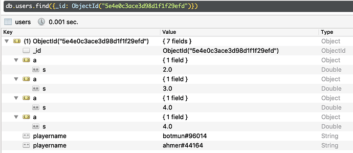

I was under the impression that this should never happen:
Playername is an indexed field, so having two instances of an indexed field is even weirder than an unindexed field.
The value “ahmer#44164” already exists in another document, so mongodb throws an error if i try to set the first playername to “ahmer#44164", but not if I do it on the second field
Querying for the playername “ahmer#44164” yields only one document

  • make a blank doc
  • right click the doc in robo3t and click edit
  • add the duplicate keys
  • save

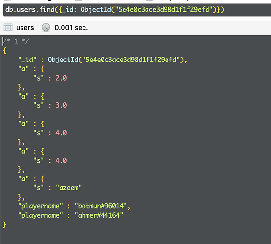

Did you verify if one of the field name is “playername” while the other is "playername "? The trailing blank at the end does not show in the GUI but it makes the field name differents. That possibility was mentionned in the link you provided. You should connect with the shell and print the document from there.
It’s exactly the same. I manually typed the two fields so there aren’t any unicode hijinks going on either.
