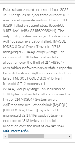

Once the collection is opened in tableau prep, what I am trying to do is group all this data by error type. Everything seems to work fine, but when it reaches the end of execution I get the following error on the Tableau server.
Hello, @Fernando Lumbreras, and thank you for sharing the information above.
The error notice GroupByStage - an allocation of 1318 bytes pushes overall allocation over the limit of 2147483647 is an error message that was raised by the BI connector due the $group stage, user internally, exceeding the 2GB max allocation that is enforced by Atlas. Notably, allowDiskUse allows a stage to grow beyond 100MB, and this message was not caused by the lack of allowDiskUse option.
Unfortunately, this limit is currently not customisable. Furthermore, even if the limit is customisable, I tend to think that with more data in your database, you would hit the elevated limitation again sooner rather than later. Thus, the only workaround at this moment is to limit the amount of data that the Tableau query pulls.
