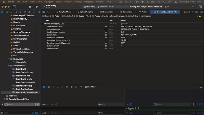

But when I finally looked at the .info file of the Realm part of my project, it said 10.52.1

However, when I look at the resource info file it still says 10.52.1
