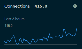

I have a NextJs app built with mongodb database.
I was surprised to see that I quickly almost reached the threshhold of maximum connections:
This app used to be built with node and react and this was never the case.
But the logic of connecting to the database has changed.
I have this function that connects to the database:

Where are you running this? Vercel? This could be related to the serverless deployment model of your hosting set up… also - what does your connection string look like? (don’t share your password, obviously - but do you have maxPoolSize set? i.e. MONGODB_URI=mongodb+srv://<user>:<pass>@cluster.mongodb.net/myDB?retryWrites=true&w=majority&maxPoolSize=10

This is indeed deployed on Vercel. And I just found this relevant discussion on Github.
My connection url looks like this:
MONGODB_URI=mongodb+srv://username:pwd@cluster0.mchmj.mongodb.net/db_name?retryWrites=true&w=majority&appName=Cluster0
