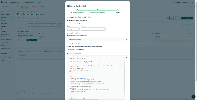

The instructions for connecting to MongoDB via X.509 are out of date. They use the deprecated options sslKey and sslCert. They have been replaced by tlsCertificateKeyFile.
Took me a day to figure that out.

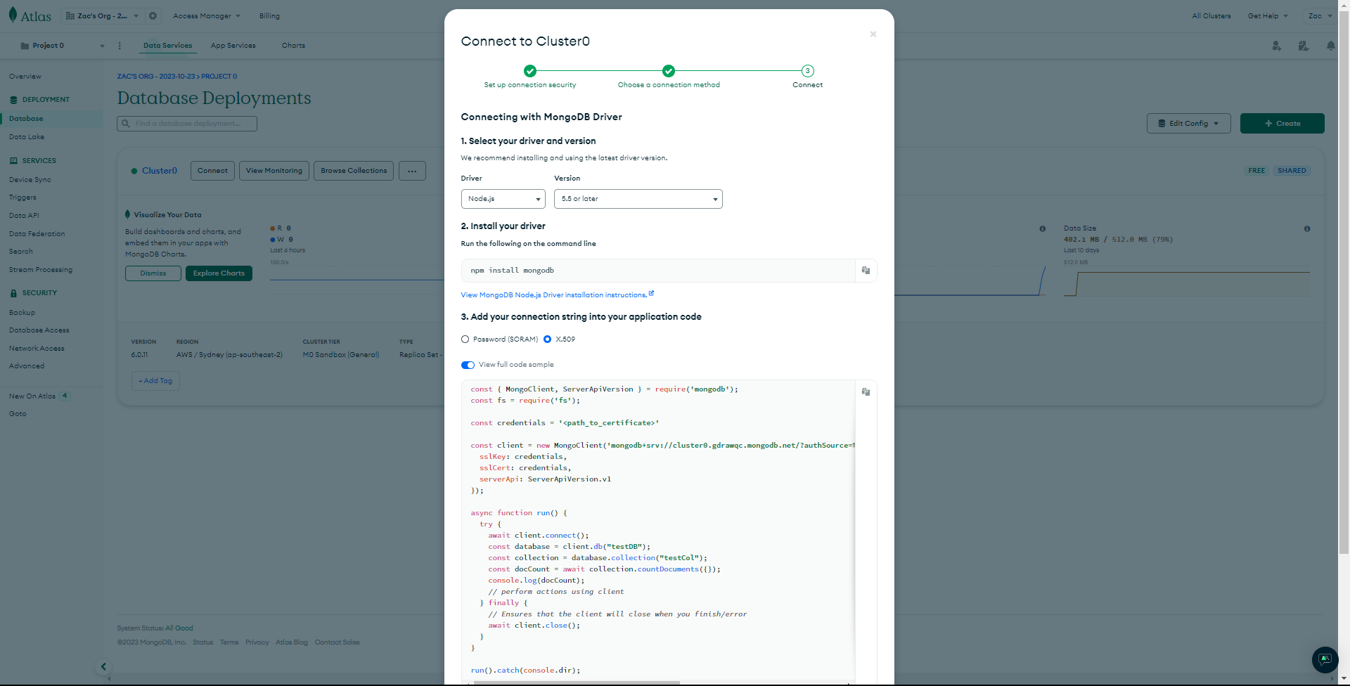

You are correct. Inside the documentation it is correct. Now that I know where to look and what I am looking for. The screenshot comes from the more user friendly dashboard that supposedly makes the basics easier.
Thanks for pointing that out @Zac_Twidale. We’ll get the docs updated so as to avoid this confusion.
@Zac_Twidale just to follow up we’re working to get the example in the connect modal adjusted. The sslKey and sslCert options were deprecated in v5 of the driver then removed in v6 (NODE-5376).
If anyone else comes across this post in the meantime, the correct sample code would be:
