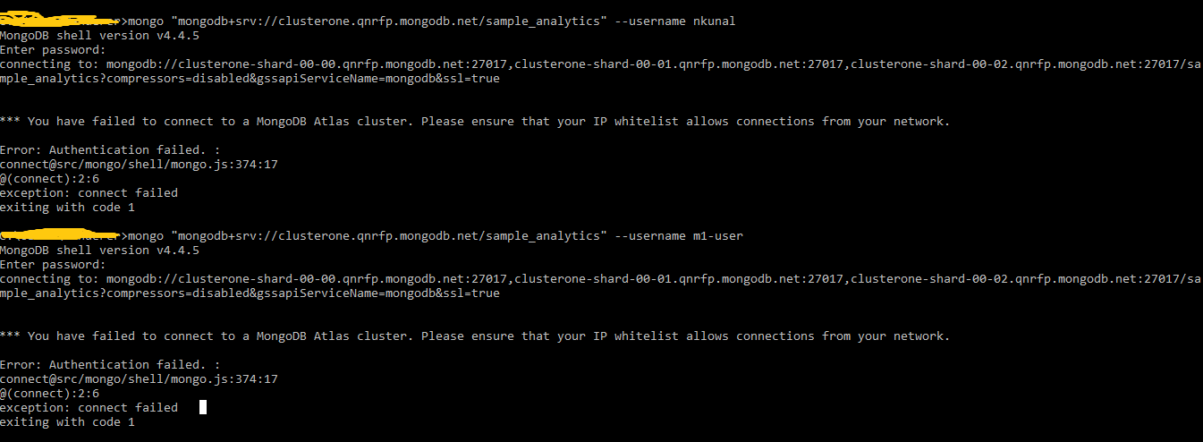

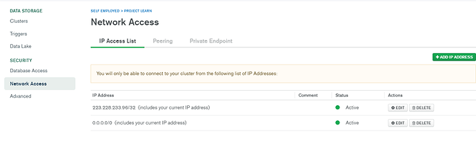

I have attached screenshots of my atlas configuration - Network Access, Database Access , Error Message
Thanks for getting back to me with that information and confirming you’ve tried different combination of credentials.
Wonder why ‘secondary server’ is picked up when connecting as below

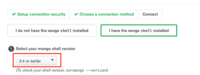

Based off your screenshots, I can see the connection attempts are being made to 3 hosts with a few other options such as ssl=true . However, I cannot see the replicaSet value. For troubleshooting purposes, would you be able to try connecting using the standard connection string format? To get this, please follow the below steps:
Head over to your Clusters section in the Atlas UI
In addition to my previous comments, I have also noticed that no authentication database is being passed through when you are connecting with the DNS seed list format which explains this error now.
As a side note, when connecting using mongoshell and using the DNS seed list format, a DNS TXT Record look up should be performed as well in which the record should contain connection options, to be added as parameters to the dynamically constructed connecting string.
Since these were not being returned whilst you were using the DNS seed list format, it could indicate a possible DNS configuration issue.
