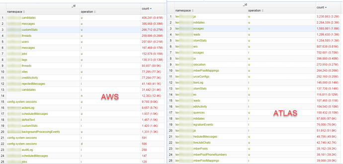

Hi Stennie,
This query was very helpful, so thank you very much for that. In looking at the query’s output, I still see the Atlas instance having a much larger count of CRUD operations when compared to the AWS-hosted instance, so I’m confused as to why with the same 16GB oplog sizing, the AWS-hosted instance still has a much shorter oplog duration. Any other ideas?

Hi @chris
As far as I can see from looking at the oplog data, and in speaking with the developers, the type of data and size of each insert/update being written is roughly the same. The amount of operations is different, as I mentioned above. The Atlas instance is receiving a much greater number of operations.
Kind regards,
Gary Hampson
I think you may have to analyze the oplog further, this doesn’t add up. Less operations but more oplog consumed on the AWS cluster?
