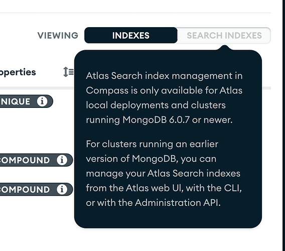

When connected in Compass I see no option to interact with Search Indexes.

@Gareth_Lowrie would you be able to share the Compass log file? https://www.mongodb.com/docs/compass/current/troubleshooting/logs/
I’m getting a “new users can’t share attachments” @Massimiliano_Marcon am I able to DM you some how?
