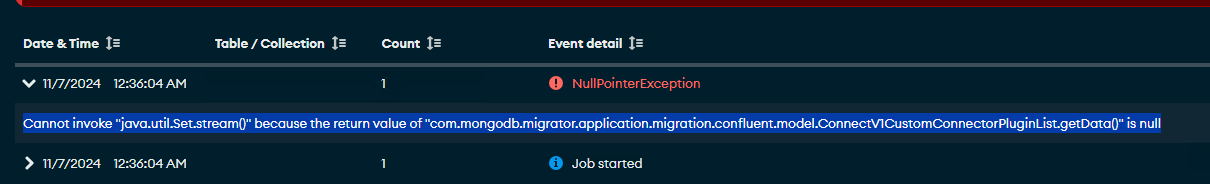

I’m migrating a production app from SQL Server to MongoDB. For the purpose, I’m using relational migrator v1.10.0.
I’ve mapped collections, designed schema and I’ve been able to run migration jobs with sample data collection set.
Because I’ve data around 30GB, I’m trying to set it up with confluent cloud kafka. When I start the job, it throws error:
Cannot invoke "java.util.Set.stream()" because the return value of "com.mongodb.migrator.application.migration.confluent.model.ConnectV1CustomConnectorPluginList.getData()" is null
Please note that I’ve configured the Confluent correctly as you can see the confluent icon here:

2024-11-07 00:36:04,611 INFO c.m.m.a.p.t.ConfluentCustomConnectorTask [pool-6-thread-1] Checking Confluent for Debezium Source Custom Connector
2024-11-07 00:36:04,634 INFO c.m.m.a.m.s.MigrationStateMachine$1 [pool-6-thread-1] Transition from: PRE_TASKS, trigger: FAIL
2024-11-07 00:36:04,638 WARN c.m.m.a.m.j.MigrationJobService [pool-6-thread-1] Migration job finished with exception
java.lang.NullPointerException: Cannot invoke "java.util.Set.stream()" because the return value of "com.mongodb.migrator.application.migration.confluent.model.ConnectV1CustomConnectorPluginList.getData()" is null

Hi @Ahmed_Rasool -
Sorry that you’ve run into this problem. This is a new issue that seems to be caused by some unexpected responses from Confluent’s API. We have a fix for this and it will be included in our next release which should be out by early December.
If you can’t wait for the new release, I’d recommend running the job without Kafka/Confluent. 30GB is not a very large job in the scheme of things and if your networking environment is good you should expect to have this complete within a few hours.
