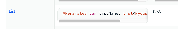

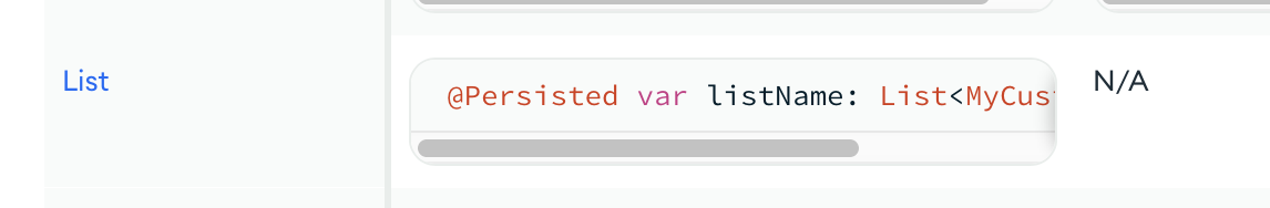

To add a bit more clarity
If this is the case now
  • the lists should be @Persisted let children: List<Second>
then the documentation should be updated
