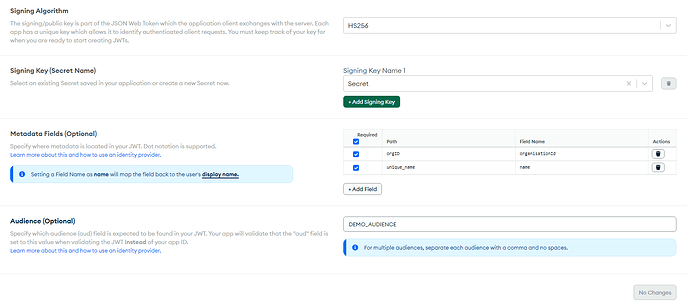

So to walk through how I’ve set all this up,
I set up my authentication to use a custom JWT:
And then from here configure everything as required:
I’ve already proven off that if the claim doesn’t exist in the JWT that the code throws an exception as expected. I am not sure though on how to see what the values of the claims are for the data mapping. Is there somewhere I can check this within Atlas as I also can’t appear to view this as part of the user object in my .net code.
