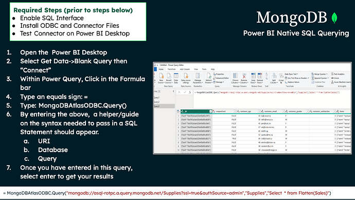

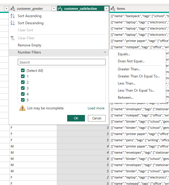

Hello Adolfo - I am happy to hear that these 2 collections/tables loaded for you within Power BI now. Per your other question, when you say “segmentation” I believe you are asking how to filter by a piece of data to narrow down results? There are multiple ways to narrow the data. First, if you always wanted the data set to be narrowed, you could created a view within Data Federation using something like $match to filter. But if you want your data set to be larger and used for many different purposes once in Power BI there are 2 methods I am aware of. Within Power Query, you can use the column menu to filter or you can use SQL within the Power Query formula bar.

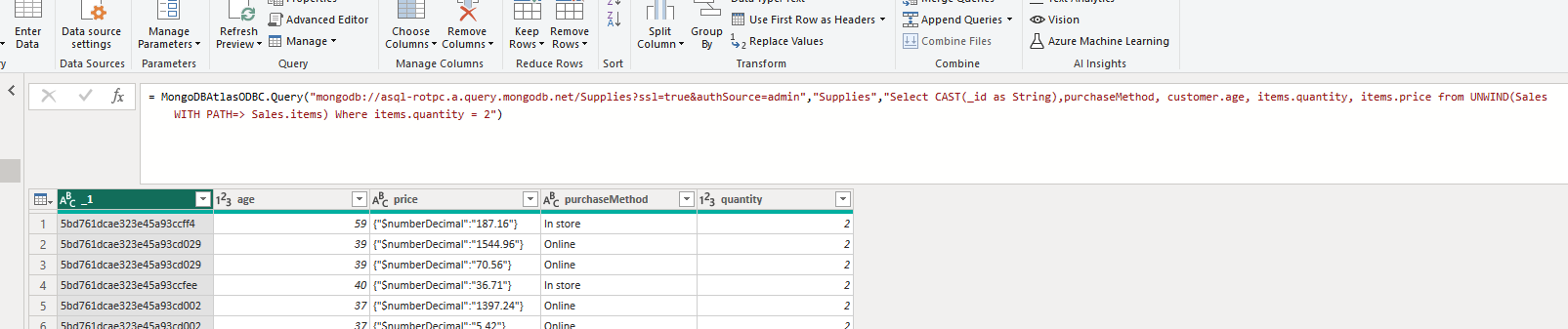

Yay - I am so happy you got things working. Here is some SQL syntax/examples that may help you.
This example uses dot notation to unwind an array
Select CAST(_id as String),purchaseMethod, customer.age, items.quantity, items.price from UNWIND(Sales WITH PATH=> Sales.items) Where items.quantity = 2
Here is where I use a cast to extract the year and filter on year extraction:
= MongoDBAtlasODBC.Query(“mongodb://asql-rotpc.a.query.mongodb.net/Supplies?ssl=true&authSource=admin”,“Supplies”,“Select CAST(_id as String),purchaseMethod, customer.age, CAST(EXTRACT(YEAR FROM saleDate)as integer) as SalesDate, items.quantity, Cast(items.price as varchar(20)) as price from UNWIND(Sales WITH PATH=> Sales.items) where CAST(EXTRACT(YEAR FROM saleDate)as integer)>2015”)
