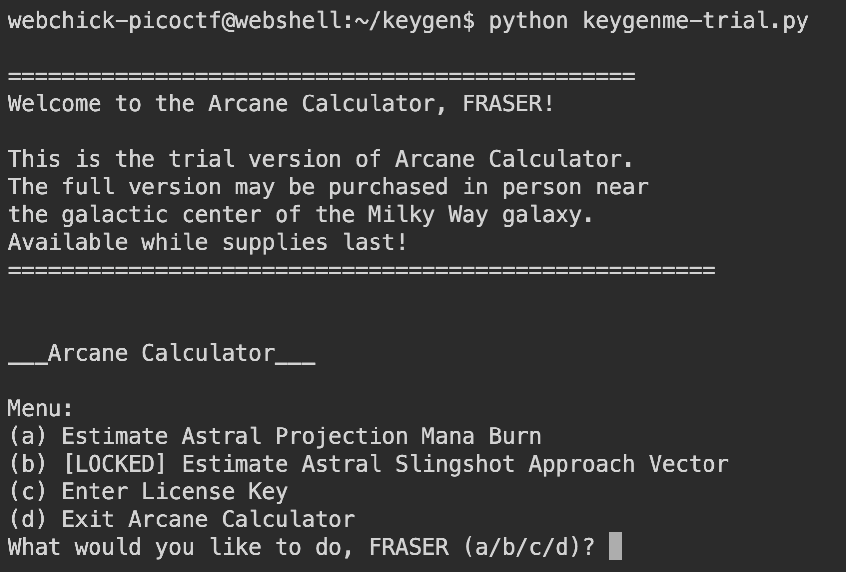

If we take a peek under the hood, there’s a lot more code here than in yesterday’s challenge. There’s code to generate the program menu, do the arcane calculations, deal with license keys, and write out the full version of the program if the key is found to be correct.
