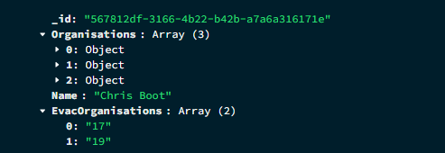

My user document is as follows:

This means that the rule attempted to expand "%%user.custom_data.EvacOrganisations" but did not find any data. I suspect that the issue is that the system cannot find the custom data because the mapping is not correct. One way to confirm this is to add something like this into the apply_when expression and I suspect you will find that the role is not selected (meaning that the custom_user is not available to the system). "%%user.custom_data": { "$exists": true }
I think the issue is that in the configuration, you are telling App Services that each user document has an _id field that maps to the app services user_id, but that is not present in the document you shared above.
I will admit it is a touch confusing, but there is an internal user_id concept. This is what you see when you go to the users tab in App Services and it is a MongoDB ObjectId (in string form) that is a unique identifier to a specific App Services user. See here: App Services
When setting up custom user data, you are telling us that for that user_id, there is a document in X collection where the value of field Y is the internal user_id.
So the system is looking up db.AppUsers.find({_id: "666ca19606b6e2fd82c6cc84"}) and it is not finding anything because you have configured the user document to have an ID that is a UUID and not anything the system knows about.

I intentionally modified my identifier in the appusers collection to be a string and not a UUID / object id so all types matched and I could rule that out as a problem. Originally it was a UUID but I’ve modified it (this was yesterday so shouldn’t have caused any issues today).

Yes, but my point is that the UUID / String-version-of-it is your concept of the user_id. Device sync and App Services has its own concept of user_id (something to uniquely identify a user). If you check the users page I linked to above you should see it. It is a hex-encoder MongoDB Object-ID.
So the way you have configured things is that we go to lookup data at the user_id that App Services knows about but it does not find a match, because you are having it point to the _id field that is a different concept entirely from the user_id that App Services uses.
What you need is to add a field to the custom data documents that has the value of the app services user_id field. It can be the _id, but if not you can name it mongo_user_id (or whatever you want), update the custom user data configuration to point to that field as the “mapping”, and then ensure that anything that inserts data into that function uses the App Services user_id.
