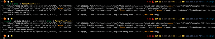

For testing purposes here are the log entries (filtering only the lines with error or exit in them). The first one is trying to start an instance up when I’ve already got one running on the defaults, and the second one when trying to bind to an IP address that is not assigned to my NIC:

Sorry for the late reply, basically I have given it like 10.10.0.0. to make it allow anything that matches this pattern and my machine IP was something like 10.10.x.x .
Am I wrong with this kind of attempt in allowing all internal IP addresses?
It did not work. So yes you were
the way you did it.
Do do that you have to use 0.0.0.0 or bindIpAll as documented.
