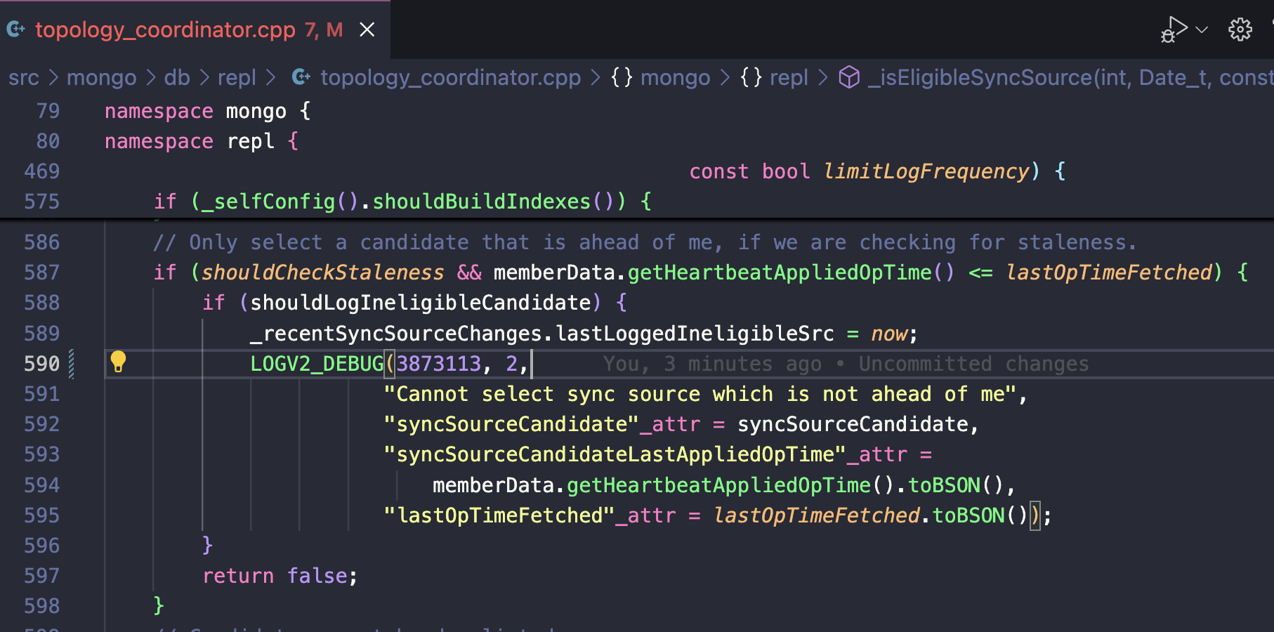

This appears to be related to the changes in SERVER-62921 which moved these messages from debug to info.
