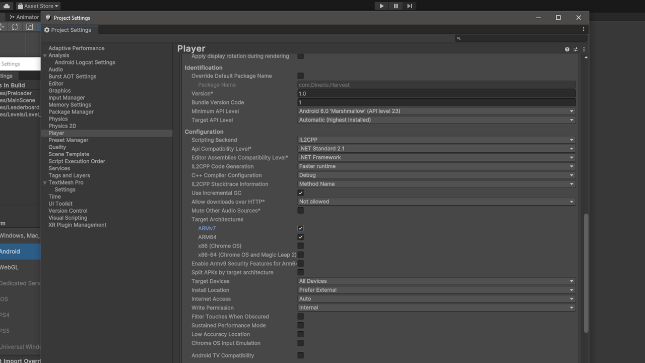

Here’s a shot of my settings, dunno if it’s helpful

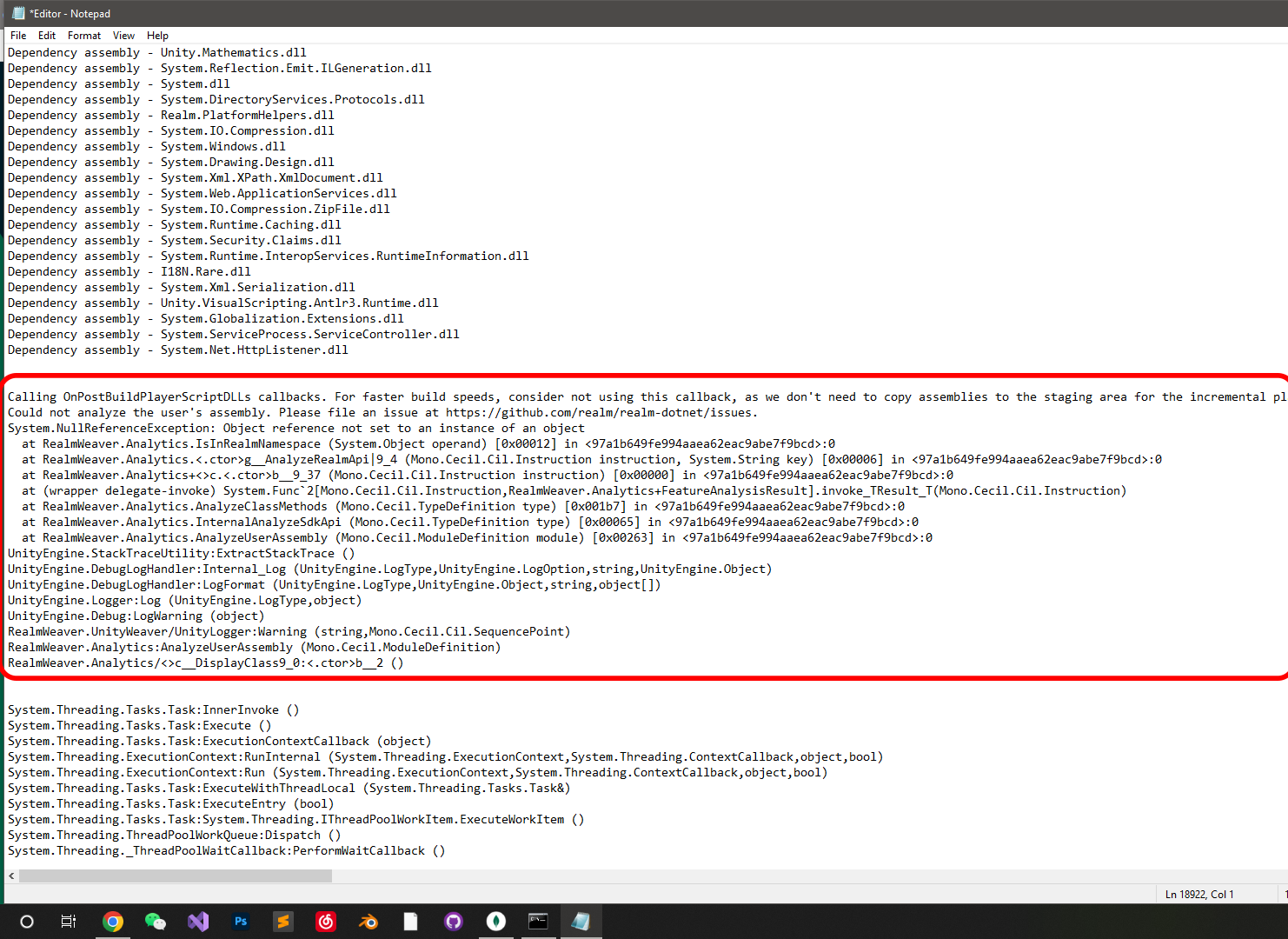

Regarding the error message, are you sure there is nothing in the build log either? I suppose that’s where the original error message showed up.
I couldn’t share the whole log file “New users cant send an attachment”, but i assume this is the warning log !
Let me know if that’s the right part !
@Slim_Hidri thanks a lot! That’s exactly the error. Now we can investigate further, thank you :smile:
