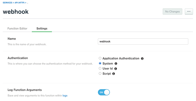

@Greg_Hammond ,
It sounds like the webhook definition is set of “application authentication” on the webhook definition. This method requires to provide at least one of your enabled authentication methods when calling the weebhook (for example a user/password via HTTP basic authetntication).
The API KEY requires you to specify a specific field either in the body or header of the call and its not x-api-key but :
  "api-key": "<User's API Key>"
If you do not need auth for the webhook you must set the authentication method to “SYSTEM”. Like in the tutorial :
Best regards,
Pavel
Thank you Pavel, I really appreciate the response. Changing the auth field from ‘x-api-key’ to ‘api-key’ in the header worked for me.
Apparently my endpoint was indeed configured to “application authentication”, as sending the api-key worked. Again, though, the current UI for configuring this stuff doesn’t even show me the Authentication section (as it does in the tutorial) – so I have no way of changing that setting, or even knowing what it is. Is that currently on a dev list?
Thanks again,
Greg
Going to answer my own question here, for others’ benefit:
The authentication method is exposed on the Settings tab within Edit Function. This is also where the “Can Evaluate” JSON expression can be specified.
Sorry for the confusion, hopefully this helps others going forward.
Greg

This is super useful. Thanks for solving. I’m new to MongoDB and working with backend data. The guides and documents from MongoDB are not very useful and quite confusing as there’s lots of assumed knowledge.
Even where to select Authentication Option of System is not very intuitive where you can only change it by selecting the word within your HTTPS endpoint “Linked Function” to go to the right section where this option is enabled.
We are there though, thanks again all!
